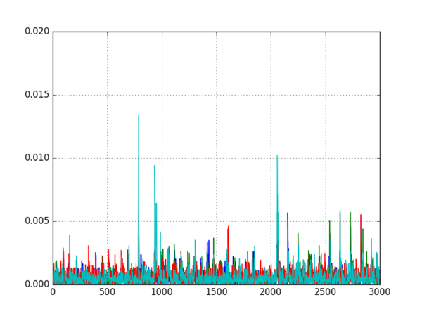

To tell the difference between the five cipher modes, DPA was used to search for the input to the AES encryption function. Recall that all five of the modes combine the plaintexts and ciphertexts in different ways to calculate the input blocks. The input for each mode uses:
| Mode | Plaintext | Ciphertext |
| ECB | Current | — |
| CBC | Current | Previous |
| CFB | — | Previous |
| OFB | Previous | Previous |
| CTR | — | — |
Using this information, the DPA attack uses the following steps:
- Use the current/previous plaintexts and ciphertexts to calculate four different possible AES inputs (the inputs for ECB, CBC, CFB, and OFB modes)
- For each of these calculated inputs, use one bit of the input to split the traces into two groups
- Calculate an average trace for each group and subtract them to get four differential traces
- Look at the differences to decide which mode is most likely:
- If one of the differential traces shows a large spike, the target is probably using that mode
- If none of the differential traces has a large spike, the target is probably using CTR mode
A simple Python script to implement this attack is:

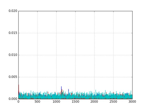

Running this script on all five datasets produced the following five graphs:
ECB:
CBC:
CFB:
OFB:
CTR:
It is quite clear from these graphs which encryption modes are being used, so the attack was successful.
