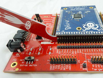

Removing / Replacing Victim Boards
The target board is removed and replaced using the removal tool. This helps avoid bending pins:
The following shows the removal process:
Adding a board involves carefully aligning the board and pushing down:
The alignment should be carefully checked if resistance is found. You may need to adjust how the board is aligned, as you should be able to press down with minimal force.
The CW308 should be turned off when swapping victim boards.
