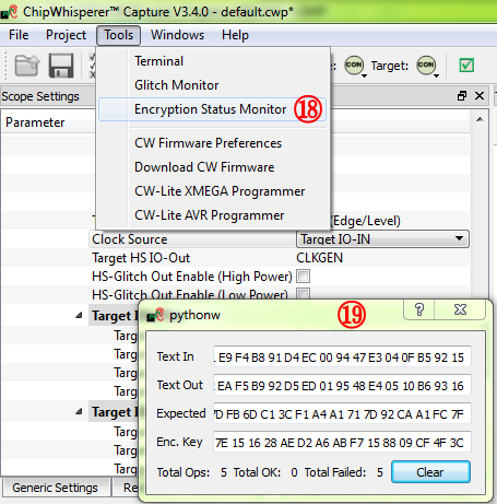

  2. Open the status monitor under Tools > Encryption Status Monitor.
  3. Resize the monitor window. The monitor will show sent & received data to the target.
  4. Hit the Run 1 button (image). You may have to hit it a few times, as the very first serial data is often lost. You should see data populate in the Text Out field of the monitor window. Note that each byte of the Text In is incremented in the Text Out field.
