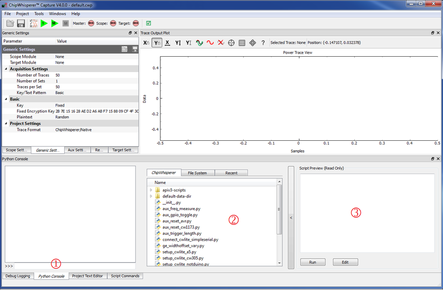

Next, open the CW-Capture software. Then perform the following steps:
  1. Switch to the Python Console tab.
  2. The script selection window (2) lists available example scripts. Scroll down to "connect_cwlite_simpleserial.py" and click on it.
  3. You will see the script contents appear in the "Script Preview" window (3). You can either hit the "Run" button or double-click the filename of the script to execute it. Do either of those now.
