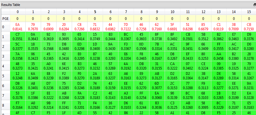

attack.setPointRange((2900, 4200))

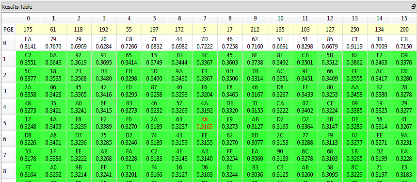

- Note that we do not know the secret encryption key, so we cannot highlight the correct key automatically. If you want to fix this, the Results settings tab has a Highlighted Key setting. Change this to Override mode and enter the key
ea 79 79 20 c8 71 44 7d 46 62 5f 51 85 c1 3b cb. - Finally, run the attack by switching to the Results Table tab and then hitting the Run button while your script is selected.
There are a few ways to check the results of the attack. First, the results table will show the best guesses for each subkey. With the highlight override enabled, the red bytes should be the best guesses for every single subkey:
However, the correct key will still rise to the top even if the wrong bytes are highlighted. The coloring and correlation coefficients in the results table should still make it clear that the top guess is the best one:
The default capture stores the WRONG knownkey, so you will have highlighted bytes that are not the correct key. We are looking instead for a large delta between the best-guess and all other guesses. For example for Byte 0 we have the most likely as 0.8141, and 2nd best guess as 0.3551. If our best guess was 0.8141 and 2nd best guess was 0.7981 this would indicate we likely haven't broken the key.
Finally, the Output vs Point Plot shows the correlation against all of the sample points. The spikes on this plot show exactly where the attack was successful (ie: where the sensitive data was leaked):
In any case, we've determined that the correct 14th round key is ea 79 79 20 c8 71 44 7d 46 62 5f 51 85 c1 3b cb.
NOTE: if you're stuck, a full listing of the attack script is given in #Appendix C: AES-256 14th Round Key Script.

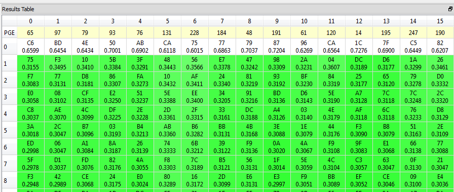

The last step is to perform the attack using this model:
- Add the above function to your custom script file.
- Change the
setAnalysisAlgorithmin the script to use your custom functions by making the following call:leakage_object = AES128_8bit(AES256_Model)
- As we did in the 14th round attack, reducing the point range can speed up the attack. For example, to use a smaller range of points, try changing the
setPointRange()function call toself.attack.setPointRange((8000,10990))
- Start the attack! Wait for the attack to complete, and you will determine the 13th round key:
Note you can check #Appendix C AES-256 13th Round Key Script for the complete contents of the attack script.
Finally, we need to convert this hypothetical key into the actual value of the 13th round key. We can do this by passing the key through ShiftRows and MixColumns to remove the effect of these two functions. This is easy to do in the Python console (assuming we had the recovered key C6 BD 4E 50 AB CA 75 77 79 87 96 CA 1C 7F C5 82, if you recovered a different key replace the knownkey value with yours):
>>> from chipwhisperer.analyzer.attacks.models.aes.funcs import shiftrows,mixcolumns >>> knownkey = [0xC6, 0xBD, 0x4E, 0x50, 0xAB, 0xCA, 0x75, 0x77, 0x79, 0x87, 0x96, 0xCA, 0x1C, 0x7F, 0xC5, 0x82] >>> key = shiftrows(knownkey) >>> key = mixcolumns(key) >>> print " ".join(["%02x" % i for i in key]) c6 6a a6 12 4a ba 4d 04 4a 22 03 54 5b 28 0e 63
Our hard work has rewarded us with the 13th round key, which is c6 6a a6 12 4a ba 4d 04 4a 22 03 54 5b 28 0e 63.
