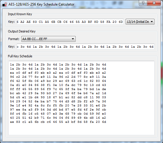

Finally, we have enough information to recover the initial encryption key. In AES-256, the initial key is used in the key expansion routine to generate 15 round keys, and we know the key for round 13 and 14. All we need to do now is reverse the key scheduling algorithm to calculate the 0/1 Round Key from the 13/14 Round Key.
In the ChipWhisperer Analyzer software, a key schedule calculator is provided in Tools > AES Key Schedule:
Open this tool and paste the 13/14 round keys, which are
c6 6a a6 12 4a ba 4d 04 4a 22 03 54 5b 28 0e 63 ea 79 79 20 c8 71 44 7d 46 62 5f 51 85 c1 3b cb
Tell the tool that this key is the 13/14 round key; it will automatically display the entire key schedule and the initial encryption key. You should find the initial encryption key is:
94 28 5d 4d 6d cf ec 08 d8 ac dd f6 be 25 a4 99 c4 d9 d0 1e c3 40 7e d7 d5 28 d4 09 e9 f0 88 a1
Peek into supersecret.h
, confirm that this is the right key, and celebrate!
