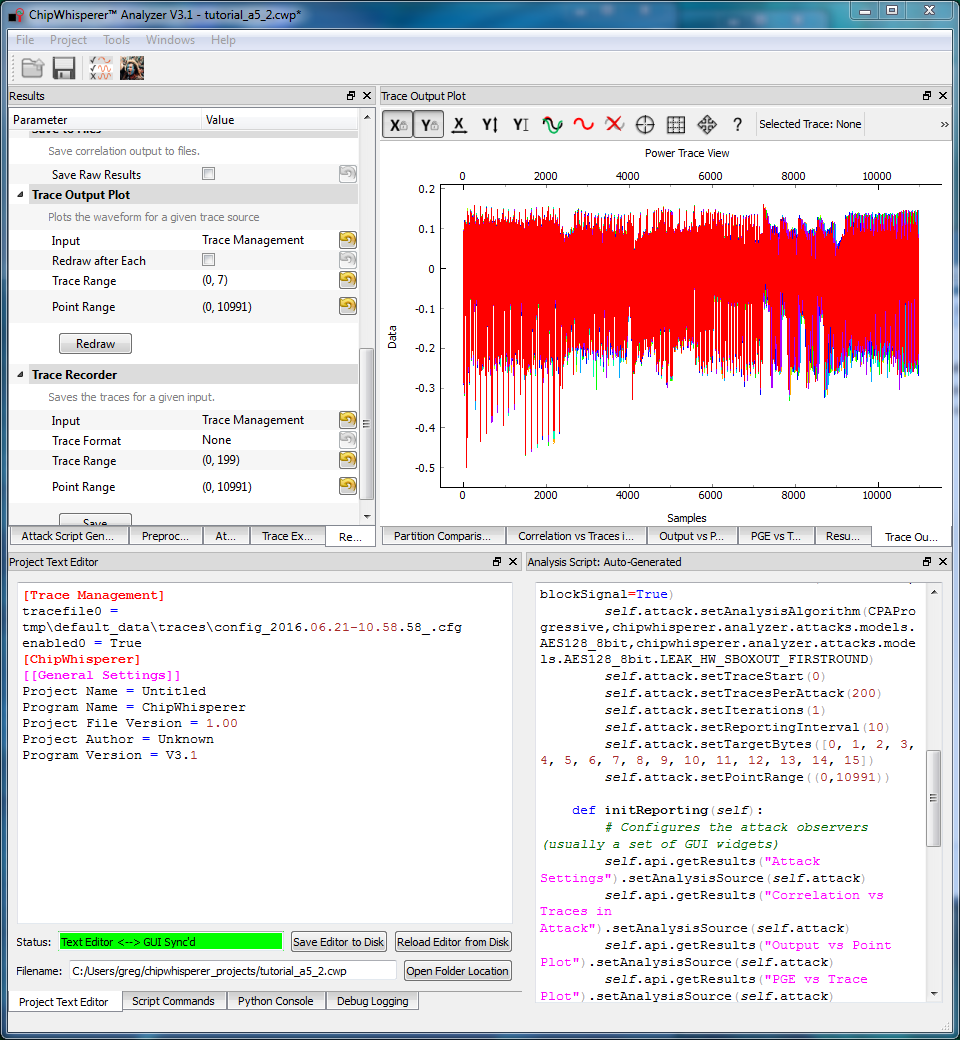

- Open the ChipWhisperer Analyzer program and load the
.cwpfile with the 13th and 14th round traces. This can be either theaes256_round1413_key0_100.cwpfile downloaded or the capture you performed. - View and manipulate the trace data with the following steps:
- Switch to the Trace Output Plot tab
- Switch to the General parameter setting tab
- Choose the traces to be plotted and press the Redraw button to draw them
- Right-click on the waveform to change options, or left-click and drag to zoom
- Use the toolbar to quickly reset the zoom back to original

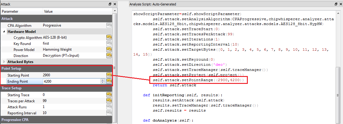

- Set up the attack in the Attack settings tab:
- Leave the Crypto Algorithm set to AES-128. (Remember that we're applying the AES-128 attack to half of the AES-256 key!)
- Change the Leakage Model to HW: AES Inv SBox Output, First Round (Dec).
- If you're finding the attack very slow, narrow down the attack a bit. Normally, this requires a bit of investigation to determine which ranges of the trace are important. Here, you can use the range from 2900 for 4200. The default settings will also work fine!

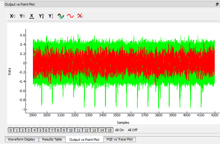

There are a few ways to check the results of the attack. First, the results table will show the best guesses for each subkey. With the highlight override enabled, the red bytes should be the best guesses for every single subkey:
However, the correct key will still rise to the top even if the wrong bytes are highlighted. The coloring and correlation coefficients in the results table should still make it clear that the top guess is the best one:
Finally, the Output vs Point Plot shows the correlation against all of the sample points. The spikes on this plot show exactly where the attack was successful (ie: where the sensitive data was leaked):
In any case, we've determined that the correct 14th round key is ea 79 79 20 c8 71 44 7d 46 62 5f 51 85 c1 3b cb.

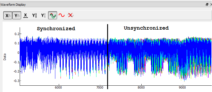

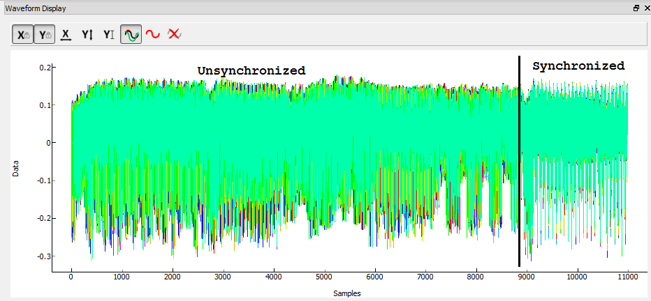

- Recall from the 14th round attack that the trace data becomes unsynchronized around sample 7000. This is due to a non-constant AES implementation: the code does not always take the same amount of time to run for every input. (It's actually possible to do a timing attack on this AES implementation! We'll stick with our CPA attack for now.)
- Resynchronize the traces:
- In the Attack Script Generator tab, enable the Resync: Sum of Difference preprocessing:
- Enable the module and configure the input points. To start, set the reference points to (9063, 9177) and the input window to (9010, 9080), but don't be afraid to change these ranges:
- Redraw the traces and confirm we now have synchronization on the second half:

self.api.getResults("Results Table").setAnalysisSource(self.attack)
self.api.getResults("Save to Files").setAnalysisSource(self.attack)
self.api.getResults("Trace Output Plot").setTraceSource(self.traces)
self.api.getResults("Trace Recorder").setTraceSource(self.traces)
