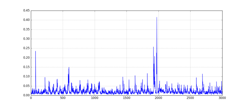

We can use these average traces to find points of interest using the sum of differences method. If this sounds unfamiliar, take a look at the theory page for a review of the math. The first step is to create a "trace" that stores these differences:
tempSumDiff = np.zeros(len(tempTraces[0]))
Then, we want to look at all of the pairs of traces, subtract them, and add them to the sum of differences. This is simple to do with 2 loops:
for i in range(9):
    for j in range(i):
        tempSumDiff += np.abs(tempMeans[i] - tempMeans[j])
This sum of differences will have peaks where the average traces showed a lot of variance. Make sure that there are a handful of high peaks that we can use as points of interest:
plt.plot(tempSumDiff)
plt.grid()
plt.show()
Now, the most interesting points of interest are the highest peaks in this sum of differences plot. However, we can't just sort the array and pick the top points. Remember (because you read the theory page, right? right?) that we need to make sure our points have some space between them. For instance, it would be a bad idea to pick both 1950 and 1951 as points of interest.
We can use the algorithm from the theory page to pick out some POIs:
  • Make an empty list of POIs
  • Find the biggest peak in the sum of differences trace and add it to the list of POIs
  • Zero out some of the surrounding points
  • Repeat until we have enough POIs
Try to code this on your own - it's a good exercise. If you get stuck, here's our implementation:
