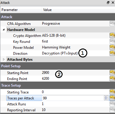

You can view or change the attack options on the Attack parameter settings tab:
- On the Hardware Model settings, ensure you select Decryption
- The Point Setup makes the attack faster by looking over a more narrow range of points. Often you might have to characterize your device to determine the location of specific attack points of interest, although you can use the range of 2900 to 4200 here for a faster attack. The default range of all the points will work fine too!
- The saved traces do not have the known encryption key stored in them. If you want to have the correct encryption key highlighted in red, switch to the Results tab and set the override key as
ea 79 79 20 c8 71 44 7d 46 62 5f 51 85 c1 3b cb
